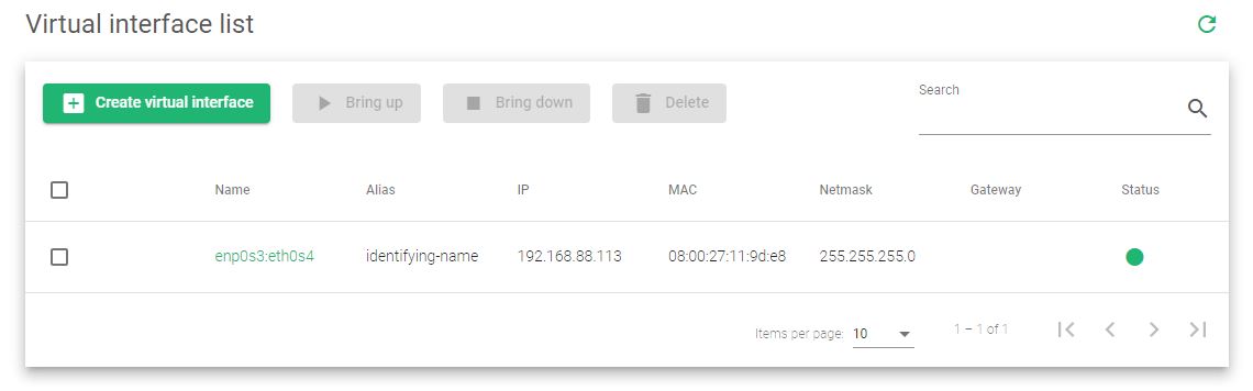

Floating IPs Table
The image below shows Zevenet EE v.6.2 table with a floating IP address that has been configured to the system.
These are the descriptions of the fields from the image above.
Interface. Name of the parent interface. This could be VLAN, bonding, or a NIC interface.
Interface Ip. The IP address of the parent interface.
Interface alias. A memorable name that easily identifies the parent interface.
Interface Virtual. The name of the virtual interface from which you’ll select the floating IP.
Floating IP. Shows only a configured IP address inherited from the virtual interfaces.
Actions. Use the following actions to set up a floating IP.
  • Configure. Assign a floating IP address to the parent interface. Only one floating Ip can be assigned.
  • Unset. Clears the configuration and removes the virtual IP address.
