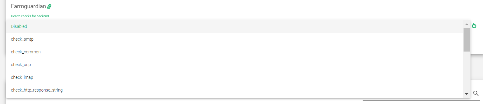

Farmguardian
L4xNAT farms do not have any built-in health checks for backends, so you must configure Farmguardian to perform health checks for this virtual service.
You can assign built-in or customized advanced health checks to this service from any existing Farmguardian check.
Farmguardian
For more information about Farmguardian, go to the Monitoring > Farmguardian section.
Once you select a Farmguardian configuration, it will be automatically applied to the farm.

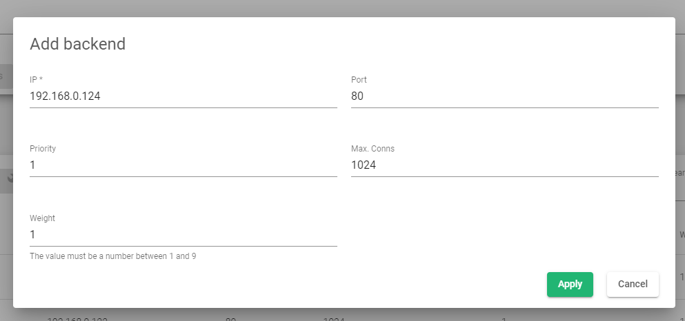

To add a new backend to a farm:
  1. Click the Create backend button.
  2. In the Add backend form, enter the following information:
    Backends
    • IP: The IP address of the backend server.
    • Port: The port number of the backend server.
    • Priority: The priority of the backend server. Lower values have higher priority.
    • Max. Conns: The maximum number of connections that can be made to the backend server.
    • Weight: The weight of the backend server for traffic balancing.
  3. Click the Apply button for the setting to take effect.
Important Notice!
The priority and weight of a backend server determine how preferable it is against other backends. Lower priority values and higher weight values indicate a more preferable backend.
If the maximum number of connections to a backend server is reached, new connections will be discarded.

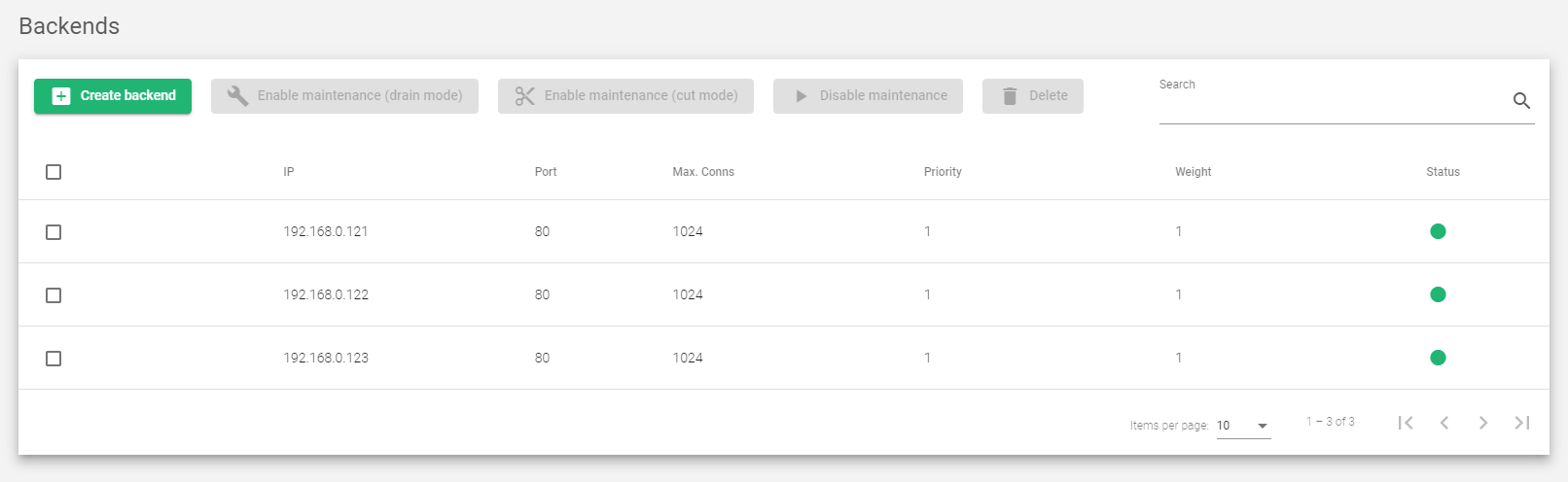

Actions:
These are the actions that can be performed on backends:
Actions that can be performed on backends
Create backend: Opens a form to add a new backend server.
Enable Maintenance: This action puts a backend server in maintenance mode, so no new connections will be redirected to it. There are two types of maintenance mode:
  • Drain Mode: This mode keeps established connections and persistence, but does not admit new connections.
  • Cut Mode: This mode directly drops all active connections against the backend, closing any connection between the backend and clients.
Edit: This action opens the edit form, which is the same as the add form, to change any backend value.
Disable Maintenance: This action enables new connections to be forwarded to the backend server again.
Delete: This action removes the backend virtual server.
This table shows all the backend servers that are already configured on the farm.
Backend servers that are already configured on the farm
IP: The IP address of the backend server that the load balancer will forward traffic to. This is the most important setting, as it determines where the traffic will go.
Port: The port number on the backend server that the load balancer will forward traffic to. This setting is typically used to direct traffic to specific services on the backend server, such as a web server or a database server.
Priority: The priority of the backend server. A lower value indicates a higher priority. The load balancer will distribute traffic to backend servers based on their priority.
Weight: The weight of the backend server for traffic balancing. A higher weight indicates that the backend server will receive more traffic. The load balancer will distribute traffic to backend servers based on their weight, taking into account their priority as well.
Max. Conns: The maximum number of connections that can be made to the backend server. If the limit is reached, new connections will be discarded. This setting can be used to prevent a single backend server from being overloaded.
