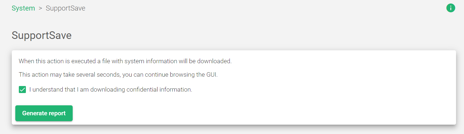

How to generate a SupportSave file:
    1. Go to the System > Support Save section of the Skudonet web interface.
    2. Enable the check box.
Support Save
  1. Click the Generate report button.
  2. A .tar.gz file containing the Skudonet load balancer node status information will be downloaded to your PC.
Notes:
  1. The SupportSave file can be used to analyze the current behavior of a node and to provide the Skudonet team with the information needed to provide the best support.
  2. The SupportSave file contains the following information:
    • Logs
    • Configuration
    • System status
