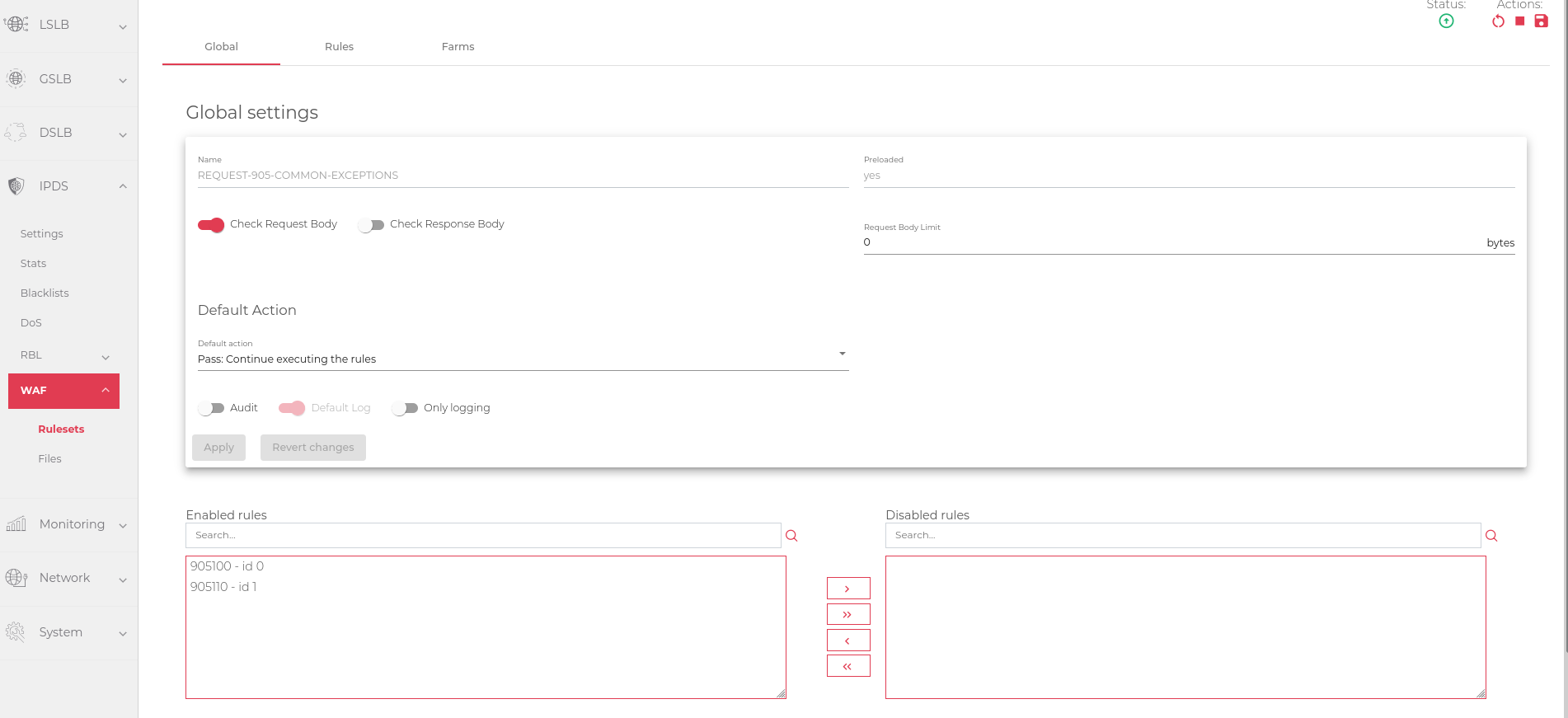

WAF Global Settings
The Global Settings WAF Rule Set section allows you to configure the behavior of all rules contained in the set. You can set the name of the rule set, whether or not to check the request and response bodies, the maximum number of bytes of the request body to save, the default action to take when no resolution is specified in a rule, the default phase to execute the rule in, and the default log action.
Here is a brief description of each setting:
Name: A unique identifier for the rule. This cannot be changed after the rule is created.
Check Request Body: Determines whether the body of HTTP requests should be analyzed. If this option is disabled, the body is not examined, and the WAF does not check the request body parameters.
Request Body Limit: Specifies the maximum number of bytes of the request body that will be saved for inspection. If set to 0, the WAF saves the entire content-length value.
Check Response Body: Determines whether the body of HTTP responses should be analyzed. If this option is disabled, the body is not examined, and the WAF does not check the response body parameters. Responses larger than 524,288 bytes (512 KB) are ignored.
Default Action: These rules apply by default. Here is a summary of each action:
    • Allow: Will enable processing of the current WAF till it finishes to complete the HTTP transaction.
    • Pass: WAF will continue evaluating the next rule without cutting the HTTP transaction.
    • Deny: Finish the current HTTP transaction. Evaluation of more rules will not be allowed. If the rule matches in phase 1 or 2 (analyzing the request), the request will not be delivered to the backend. If the rule matches in phase 3 or 4 (analyzing the response), the response will not be delivered to the client.
    • Redirect: The HTTP transaction will be halted and an HTTP redirect will be sent to the client.
Redirect URL: The URL that is sent to the client when a rule matches. This URL has a predetermined redirect resolution.
Default Log: A default logging action. This value is used if no specific logging action is specified in the rule settings.
Only Logging: When this option is enabled, the resolution parameter of the rules in the set will never be executed. This mode is only available when the set is running.
Rules
The image above shows two tables, one for Enabled rules and the other for Disabled rules.
  • Enabled Rules: This is a list of all the rules that are currently enabled in the set. Each rule is identified by its rule ID and description parameters.
  • Disabled Rules: This is a list of all the rules that are currently disabled in the set.

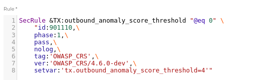

Editing a WAF in Raw Mode
If the form mode is not enough to describe a WAF rule, and the administrator is familiar with the SecLang syntax, they can create rules or a batch of rules in raw mode. This mode accepts any instructions, including instructions and parameters that are not supported by the form mode, additionally SKUDONET v10 includes a syntactic analyzer that highlight the code, this functionally help to the administrator to create own rules easily, at the moment of saving any change an additional check is done against the SKUDONET syntactic core checker, indicating if there is some error in the rule, in that case the rule will not be saved.
Edit in Raw mode:
Raw mode is more powerful than form mode but is also more difficult to use. It is important to understand the SecLang syntax before using raw mode to edit WAF rules.
If you want to know more about Seclang compatible with SKUDONET v10, please refer to this Seclang ModSecurity v3:

The Farms WAF Settings section allows you to assign the current WAF rule set to one or more HTTP(s) farms.
To enable or disable WAF rules on a Farm, Drag and Drop them from the Available farms to the Enabled farm box or vice-versa.
Seclang and SKUDONET WAF can be used to extend functionalities in the proxy, like Auditing traffic, please refer to this article if you want to know more about how to use SKUDONET WAF.
