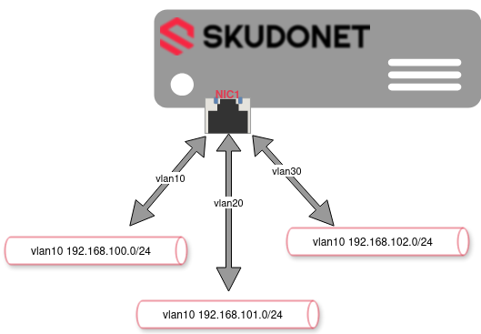

Let’s consider a scenario where an organization has three distinct departments: Security, Engineering, and HR. Each department has its own unique data security and access requirements. By implementing VLANs, the organization can logically segment the network into three separate VLANs, one for each department.
  • Engineering VLAN: The Engineering VLAN would be assigned VLAN ID 10 and would be used to house all engineering workstations and servers.
  • HR VLAN: The HR VLAN would be assigned VLAN ID 20 and would be used to house all HR workstations and servers.
  • Security VLAN: The Security VLAN would be assigned VLAN ID 30 and would be used to house all security-critical devices, such as firewalls, intrusion detection/prevention systems (IDS/IPS), and security information and event management (SIEM) systems.
Consider the image below.
By segmenting the network into separate VLANs, the organization can ensure that sensitive data is only accessible to authorized personnel. For example, employees in the HR department would not be able to access data on the Security VLAN, and employees in the Engineering department would not be able to access data on the HR VLAN.

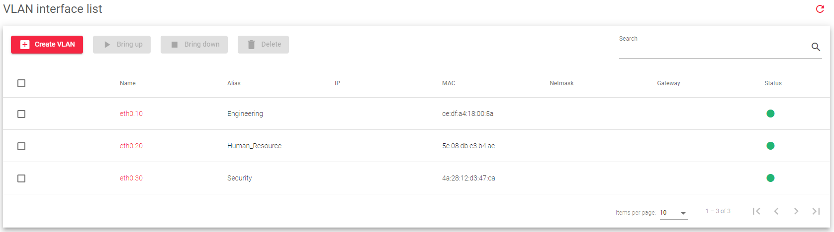

VLAN Interfaces List
This table shows all the VLAN interfaces that are configured in SKUDONET ADC.
The table above shows the VLAN interfaces on the system and their configuration information.
Name: A unique identifier for the VLAN interface.
IP: The IP address of the VLAN interface. Supports both IPv4 and IPv6.
MAC: The MAC address of the VLAN interface. The VLAN inherits the MAC address from the parent NIC.
Netmask: The subnet mask of the VLAN interface. Can only be configured if the IP address is also configured.
Gateway: The default gateway used by the VLAN interface. Must be on the same subnet as the VLAN interface.
Status: The status of the VLAN interface.
  • Green: The VLAN interface is up and running.
  • Red: The VLAN interface is down.
Perform the following Actions in the VLAN section:
  • Create VLAN: Create a new VLAN interface.
  • Bring Up: Start the interface and allow it to receive and transmit traffic.
  • Bring Down: Stop the interface from receiving and transmitting traffic.
  • Delete: Remove the VLAN interface.
  • Edit: Change the VLAN configurations, such as the IP address, MAC address, netmask, and gateway.
