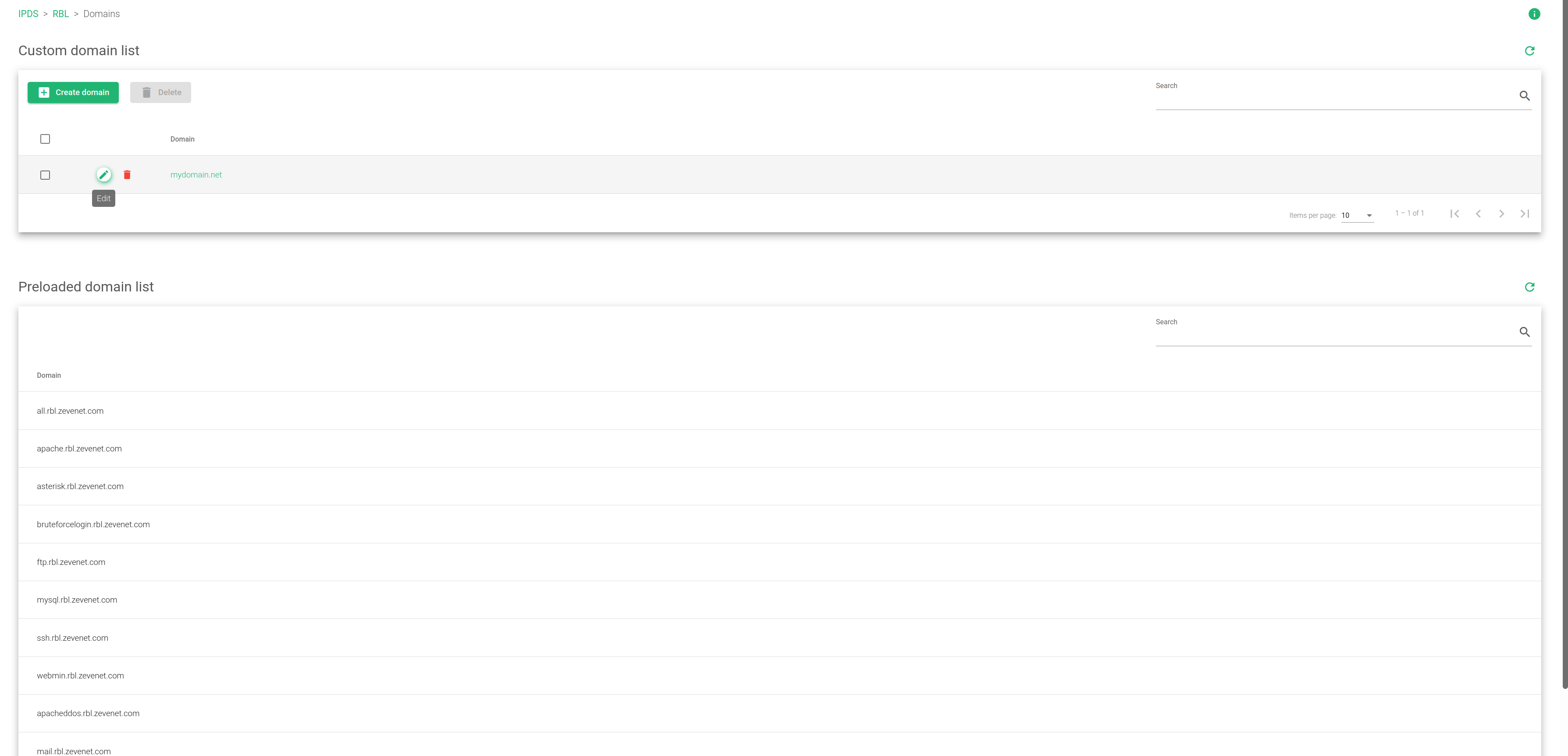

In this section, you’ll learn how to add or remove your custom domains. If your company has a DNS with an up-to-date custom list of dangerous, forbidden, or whatever reason list of IP addresses that you desire to block, this is the section where to use it.
Preloaded Domain List
The bottom section shows the preloaded domains which are maintained and updated by ZEVENET Team. If one of ZEVENET’s domains is used, your load balancer will query it first. ZEVENET DNS for RBL rules is ns1.rbl.Skudonet.com and ns2.rbl.Skudonet.com. Please, ensure that those DNS are reachable from your load balance appliance.
As mentioned, to make it work the load balancer must have connectivity to ZEVENET DNS.
These direct queries to ZEVENET DNS increase system performance. If ZEVENET DNS is not used, usually the query is done against a different DNS (for example 8.8.8.8) which later it will resend the query to the final DNSBL (DNS BlackList) server (for example blocklist.de).
For this purpose, the aforementioned increase in performance, ZEVENET keeps a mirror of DNSBL from blocklist.de The mirror is updated daily.
Custom Domain List section allows you to add, delete or edit your custom domain. Each domain added should be a DNSBL (domain name server block list).
