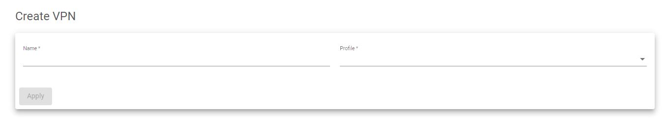

When you click the Create VPN action, it’ll open a form that looks similar to the one in the image below.
Skudonet network vlan create
Use the Name field to give the VPN a suitable label, and the profile to select the VPN type to implement.
