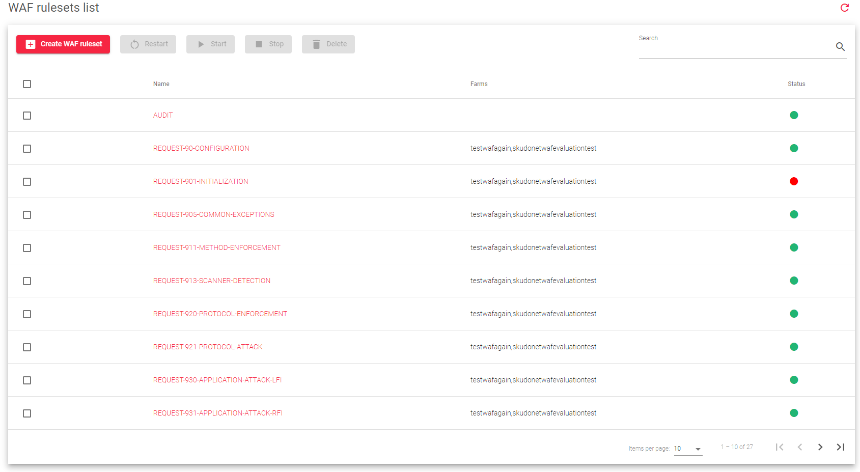

The image below shows a list of preconfigured WAF rules:
Below are the descriptions for each field in the table shown in the image above.
Name: A unique name for the ruleset.
Farms: The farms to which the ruleset is applied.
STATUS: The ruleset status is represented by the following color codes:
  • Green: Enabled. The ruleset is being checked for the farms that are using it.
  • Red: Disabled. The ruleset is not enabled, so it is not having any effect on the farm.
Actions: The following actions are allowed for the status of the WAF rules:
  • Create WAF ruleset: Opens a form to create a new WAF ruleset.
  • Edit: Modify the ruleset settings or assign a farm service, if needed.
  • Restart: Reinitialize a WAF rule.
  • Start: Apply the WAF ruleset.
  • Delete: Remove a ruleset.
