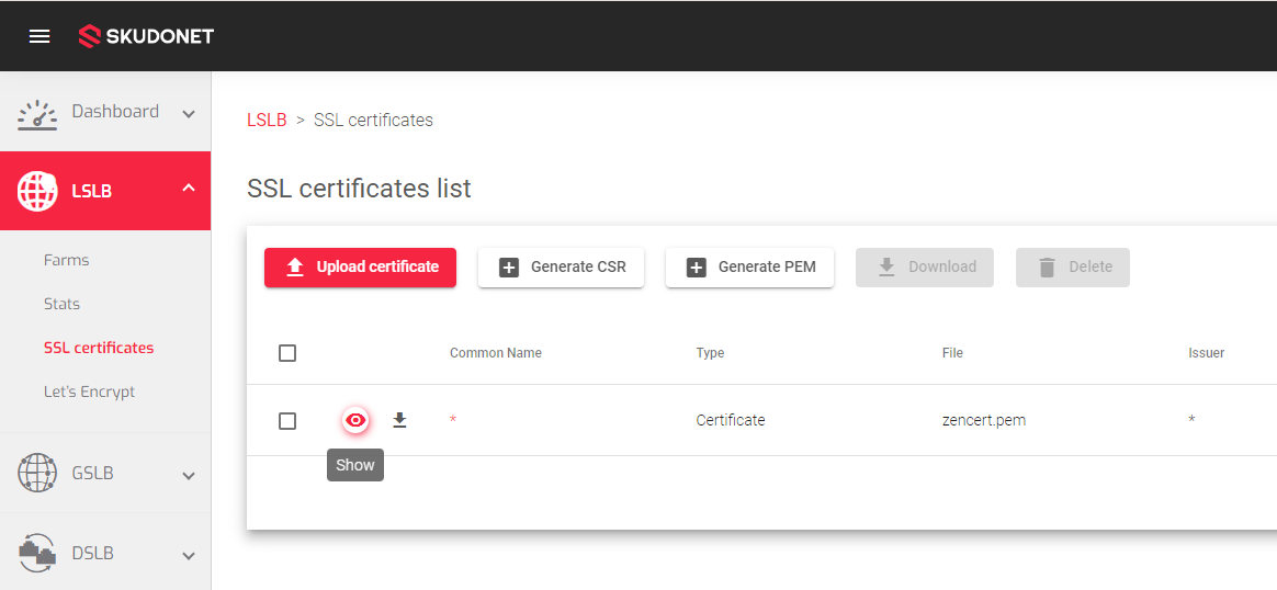

This section is about viewing SSL certificate information. When you click on a domain name in the Common Name column or the Show icon, the certificate’s details will appear.
In the provided image, clicking on the Show icon displays the certificate saved on the ADC.
After clicking the Show icon, the following information is displayed.
