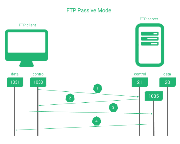

Passive FTP Mode Configuration
A passive FTP setup only uses port 21 in the servers or backends side. The picture below shows how the connection flows when data is required to be transferred between a client and a FTP server.
passive_ftp_client_server
In the sequence shown above:
1. The client requests to the server via port 21 a command.
2. The server acknowledges the client.
3. The client initiates the data connection using a high data port to an application layer agreed port on the server side.
4. The server acknowledges the client when it’s finished.
At this point, we’ve to set up a load balancer between both client and server and then take care of the traffic flows, connections initializers and port agreements between client and server.
With SKUDONET Load Balancer, we’ve to achieve this kind of configuration by creating an LSLB farm profile L4xNAT with the port 21 and FTP protocol, as shown in the picture below, and finally setting the backends (not required to set the ports).
skudonet_adc_lb_passive_ftp_configuration
The clients have to connect to the VIP address of the new FTP farm.
