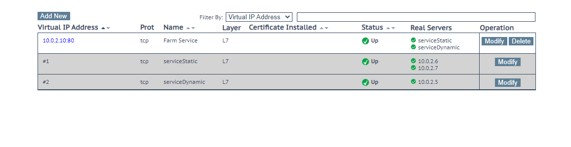

Two service groups must be created on a virtual server. In these example configurations, we shall create the service groups serviceDynamic and serviceStatic to demonstrate content switching with Kemp and how you can achieve that with SKUDONET ADC.

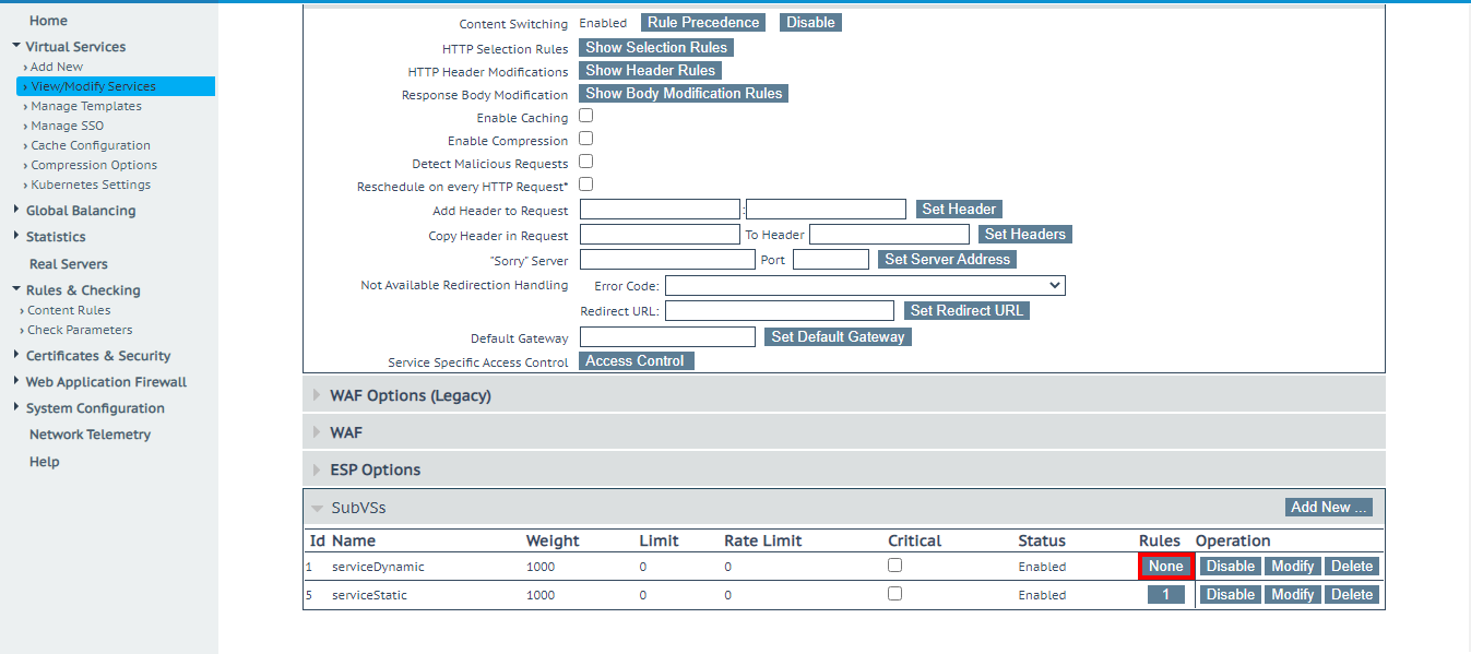

    1. After creating content rules, enable that rule on a subVS that you want to match. Click the Modify button on a Virtual Service. Scroll till you reach the Advanced properties setting and click the Enable button aside from content switching.
    2. Scroll to the table at the bottom. Within the column with the heading Rules, click the one with None to add a rule.
  1. After adding a rule, the status will change from None to 1. For this example, all the traffic that matches this rule will be forwarded to a subVS with static content. All traffic that does match this condition will be forwarded to the subVS with dynamic content.

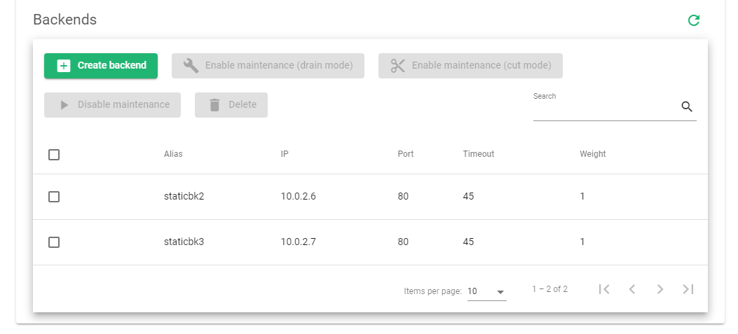

  3. Create Backends to distribute static resources.
All the traffic from the web that matches the conditional within the URL pattern parameter will get distributed among the listed Backends. Those that do not match will be forwarded to the service serviceDynamic. Make sure to enable session persistence.
