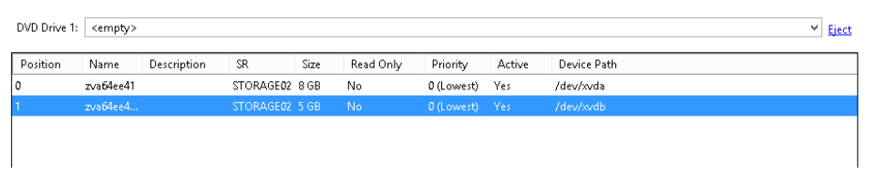

Now from the HyperVisor Client attach to the virtual load balancer a new virtual disk with 5GB.
resize fs virtual disk adc
In our example a new device will be detected inside the virtual load balancer with device name /dev/xvdb.

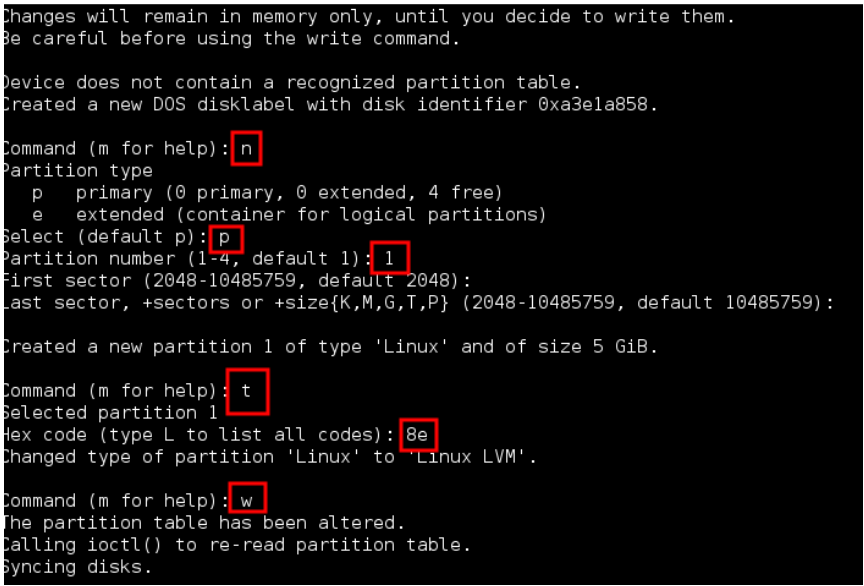

Now prepare the device /dev/xvdb to be included in LVM:
root@zva#> fdisk /dev/xvdb
And execute the following actions.
resize fs virtual disk adc with lvm
A new device with name /dev/xvdb1 has been created.
