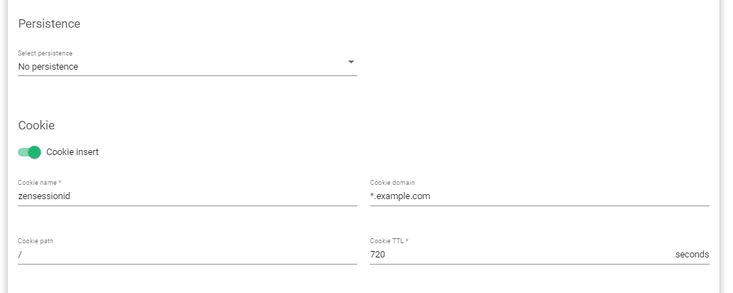

To enable cookie persistence when using SKUDONET load balancer:
  1. Go to LSLB > Farms and Click the Edit Icon on an http farm.
  2. Navigate to the Services Tab.
  3. Scroll till you reach the persistence section.
  4. To enable persistence using the Client’s IP address, select persistence IP: client address.
  5. oracle_jd_edwards_load_balancing_farm
  6. To enable session persistence using a cookie, Ignore step 4 and leave the Persistence field at No persistence.
  7. Toggle on the cookie insert button and fill in the name, domain, path, and Time to Live(TTL) in Seconds.
  8. Update the settings by clicking the Apply button.
