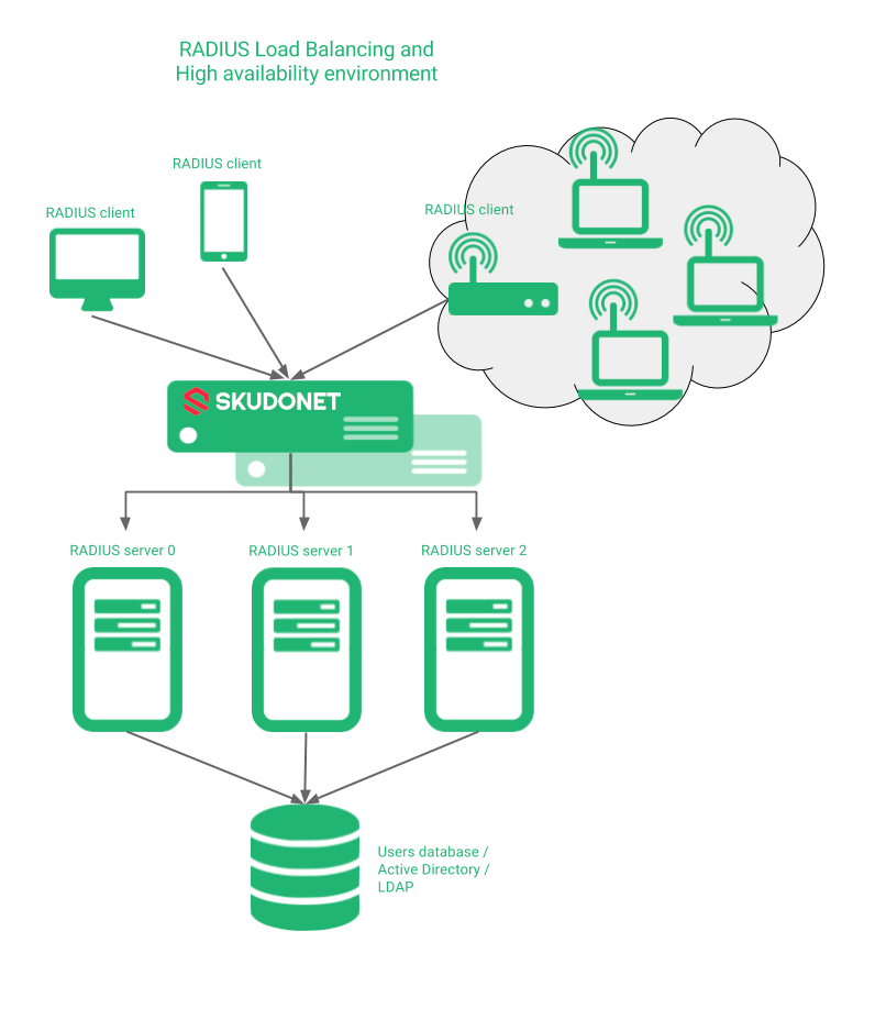

RADIUS load balancing and high availability environment
The problem if a RADIUS service is down could produce the risk of users not being able access to a server network or login into an application, users can’t open a session into a device or being unable to get the authorization to use a right in a business process. To solve that kind of situation, this article aims to setup the environment shown below.
SKUDONET will share the RADIUS protocol messages among all the RADIUS servers, whether they’re in different or local sites. In the following sections, we’re explaining the configuration of this kind of environment, the advanced health checks for RADIUS services and the security challenges of this protocol.
