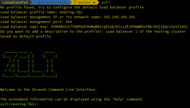

Once zcli is installed, it can be started by executing zcli in the shell. If it is executed from the load balancer, it will run with the default profile localhost which manages the local load balancer and the ZAPI key will be requested. In any other case, the configuration assistant will be started.
ZEVENET zcli profile creation

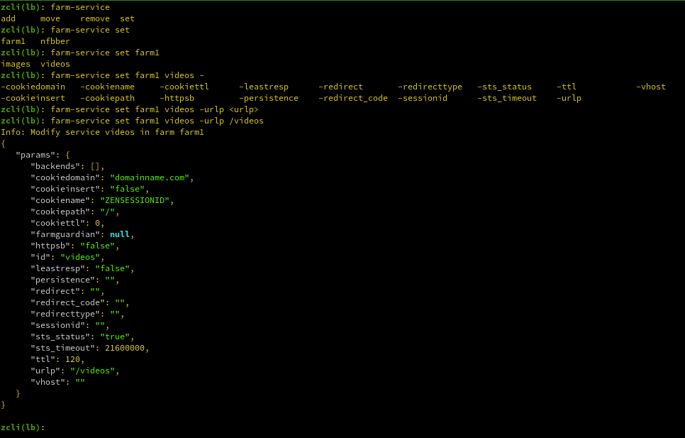

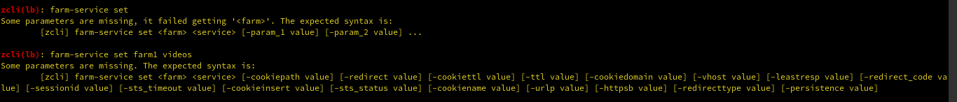

The expected command arguments can be retrieved pressing Enter. Sometimes parameters are not expanded until the previous arguments are set.
ZEVENET zcli help descriptions
zcli has an auto-completion functionality that can be triggered pressing double TAB button.
ZEVENET zcli autocompletion
