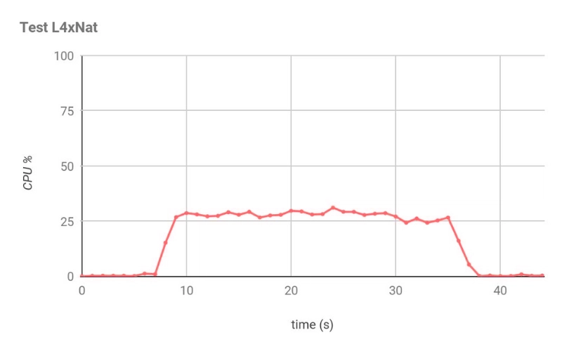

CPU usage in SNA7108
While the test was running, the CPU in the SNA7108 was used as follows:
CPU usage in SKUDONET Network Appliance
As it’s shown above, all CPUs reached an average of 27,7% and were moving more than 475,000 request per seconds, HTTP requests are managed smoothly.
