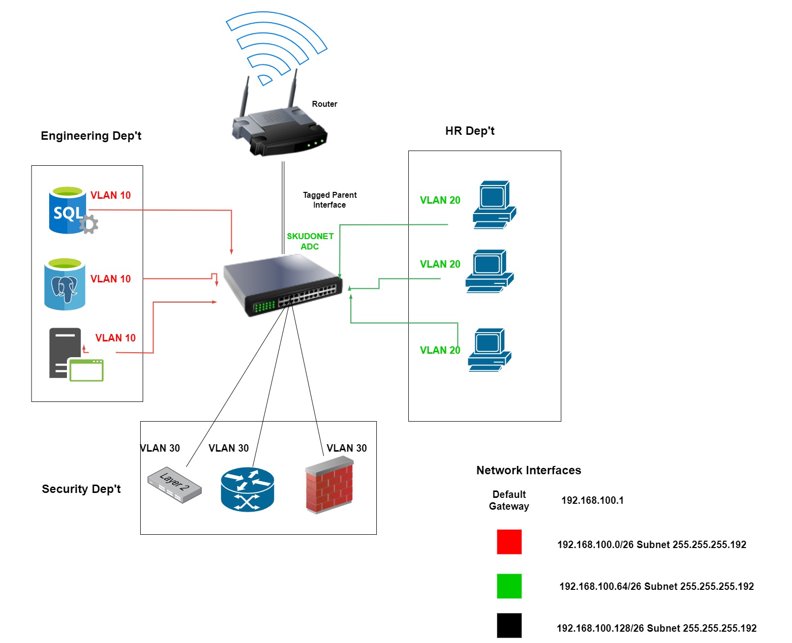

Let’s consider a scenario where an organization has three distinct departments: Security, Engineering, and HR. Each department has its own unique data security and access requirements. By implementing VLANs, the organization can logically segment the network into three separate VLANs, one for each department.
  • Engineering VLAN: The Engineering VLAN would be assigned VLAN ID 10 and would be used to house all engineering workstations and servers.
  • HR VLAN: The HR VLAN would be assigned VLAN ID 20 and would be used to house all HR workstations and servers.
  • Security VLAN: The Security VLAN would be assigned VLAN ID 30 and would be used to house all security-critical devices, such as firewalls, intrusion detection/prevention systems (IDS/IPS), and security information and event management (SIEM) systems.
Consider the image below.
Virtual Local Area Networks (VLANs)
By segmenting the network into separate VLANs, the organization can ensure that sensitive data is only accessible to authorized personnel. For example, employees in the HR department would not be able to access data on the Security VLAN, and employees in the Engineering department would not be able to access data on the HR VLAN.
