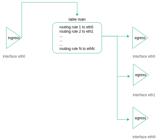

Exploring a Basic Routing Setup
The diagram below provides insight into the decision-making process of a straightforward routing system when it comes to packet forwarding:
The journey begins when the packet ingress the device through eth0. The routing table then examines the packet’s destination. Subsequently, the packet is directed to a designated interface to be egressed. This operational approach is both uncomplicated and valuable.

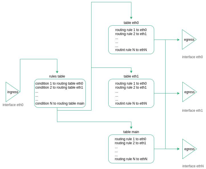

Exploring Advanced Routing in SKUDONET ADC
As we’ve previously mentioned, the SKUDONET ADC device incorporates a sophisticated routing system. In this setup, the packet’s course is initially determined by a process referred to as “rulerization.” Subsequently, the decision is made regarding which table the packet should be forwarded to:
The routing module of SKUDONET ADC was conceived based on the following principles:
Each network interface (NICs, VLANs, or Bonding) independently manages its own routing table and gateway.
Traffic directed at a Virtual IP (VIP) is controlled by the same routing table for both incoming (from client to load balancer) and outgoing (from load balancer to backend) traffic.
Upon reaching a farm, each packet is marked, and this marking determines the subsequent redirection of the packet.
The routing system is designed to maintain simplicity by minimizing the usage of static routes, as adding more interfaces would otherwise increase complexity.
When the ADC needs to connect to external systems, such as navigation proxies, DNS, or hotfix reviews, a dedicated table (referred to as “table main”) is employed.
Load-balanced traffic employs distinct tables from the main routing table, facilitating the separation and isolation of various traffic types.

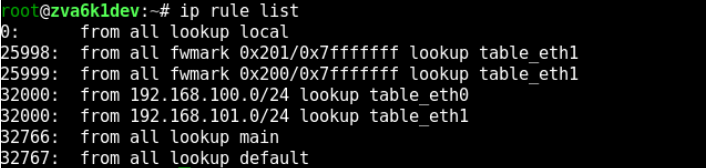

You can list the routing rules using the following command:
ip rule list
As indicated by the ID 25998, all traffic marked with mark 201 will be directed to the table table_eth1. Now, let’s examine the content of table eth1:
When the packet attempts to reach the backend 192.168.200.20, it is noted that this destination IP is not directly accessed. Consequently, the default gateway will be utilized, and the packet will be forwarded to 192.168.101.5 as the next hop.
