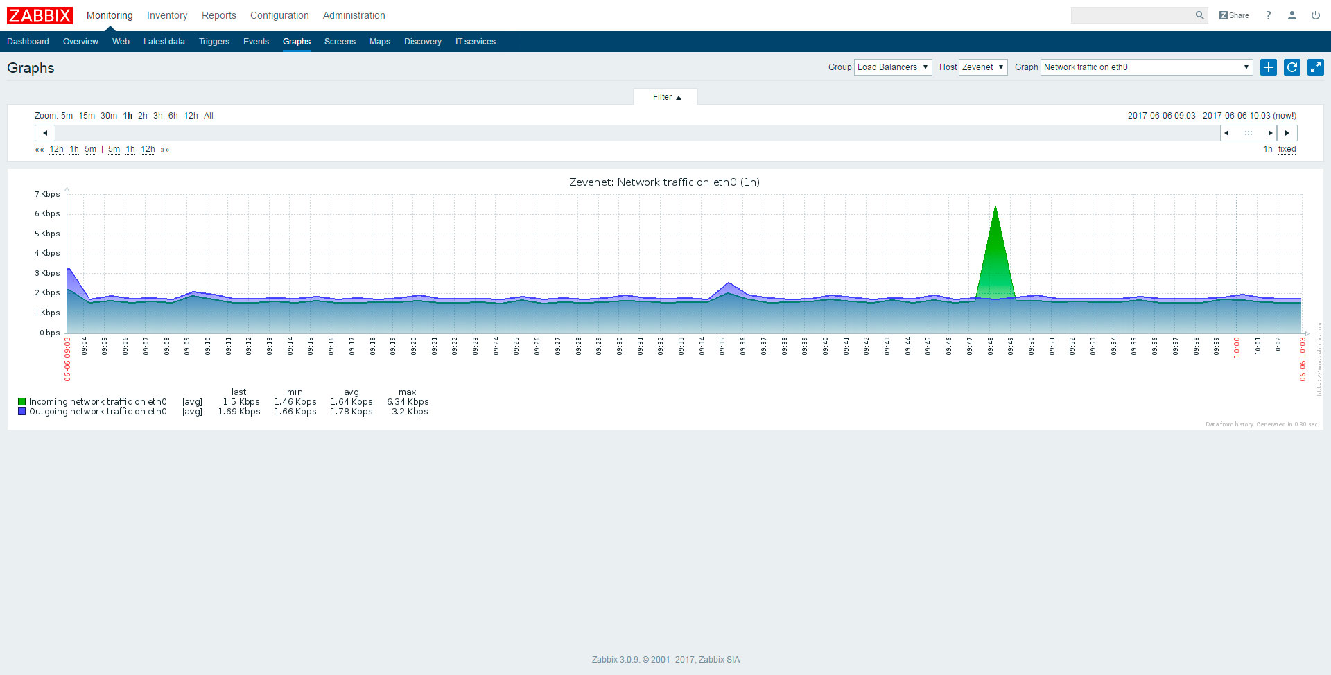

Performance graphs
That’s all! You can check all the metrics that Zabbix are able to get out of the box. Go to Monitoring > Graphs and select the graph type you want to see.

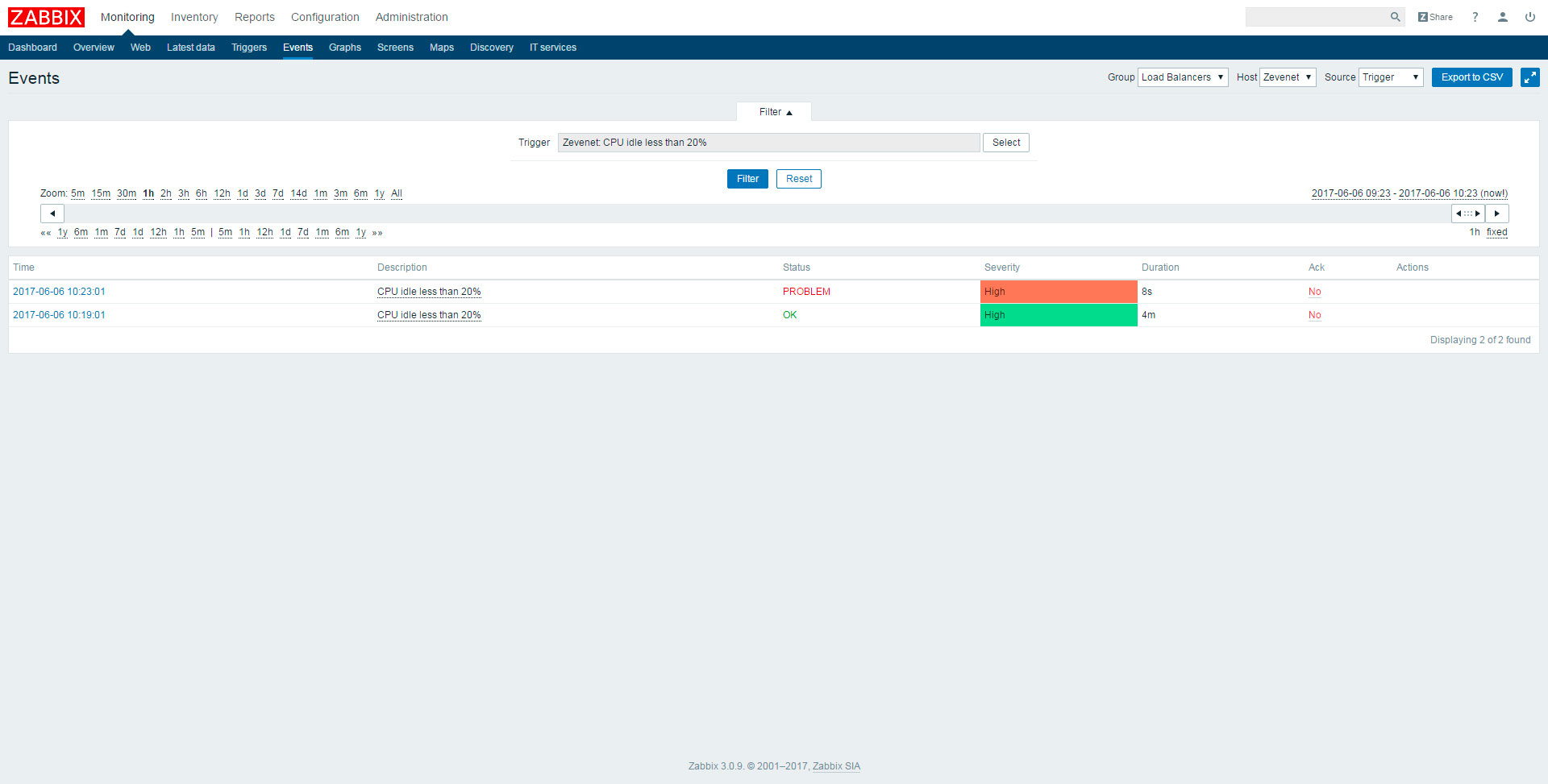

Create a custom trigger in Zabbix Server to monitor Zevenet appliance CPU usage
Now we have our Zevenet ADC Load Balancer monitored with a minimum effort, so now what? We are going to see how to create a custom trigger in Zabbix Server to monitor a specific behavior.
Let’s say that we need to monitor the CPU usage of a Zevenet appliance, and to be more specific let’s say that we want an alert in Zabbix Server if the CPU usage is higher that 20%.
1. Go to Configuration > Hosts, click on Zevenet host, click on Triggers and then click on button Create trigger.
  • Name: (Mandatory) Name of the trigger (i.e: CPU idle less than 20%)
  • Expression: (Mandatory) {192.168.100.10:system.cpu.util[,idle].last()}<20 (Click on Add button to use a wizard to build the expression)
  • Multiple PROBLEM events generation: (optional)
  • Description: (optional)
  • URL: (optional)
  • Severity: (Mandatory) High
  • Enabled: (Mandatory) Checked
2.Click on Add button.
To test the trigger we have just created login as superuser in Zevenet ADC Load Balancer and type this command:
IMPORTANT: DON’T TYPE THIS COMMAND IN A PRODUCTION LOAD BALANCER, TEST IT IN A DEVELOPMENT ENVIRONMENT. IT PRODUCES A 100% CPU USAGE!
for i in 1 2 3 4; do while : ; do : ; done & done
Go to Monitoring > Events and wait to see a ‘CPU idle less than 20%’ event triggered.
